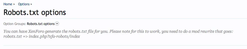

Here is my sitemap in webmaster tools - it appears to be working. Shouldn't the robots.txt instructions be in the core explanation of the add on, not barred in the 38 pages of the discussion? just sayin…Also, the robots.txt code above unfortunately did not work. I will se if i can get an answer on the add ons discussion are from the author. Thanks @Tracy Perry

If you turn it off then you have to manually create a robots.txt. The re-write will depend on what web server you use (and it has to be in the .htaccess for Apache). I haven't used Apache in so long I'm not sure where/what it would need - but I provided the one for nginx that works earlier. Assistance for this add-on would be more appropriate in the discussion area for it as it is not XenForo problem/question but the add-on. I noticed that you run your site in a /community directory - so the rewrite example for nginx would need to be modified accordingly. It is based upon running your forum in the root.

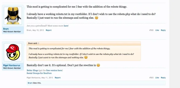

So reading through some of the discussions on the sitemap add on I ran across this- apparently its just an option so i don't think the add on is the issue - and i have my own robots.txt so it must be something in my .htaccess file. The only thing I ever added was @Jake Bunce redirect suggestion. I wish someone could chime in with a solution...
