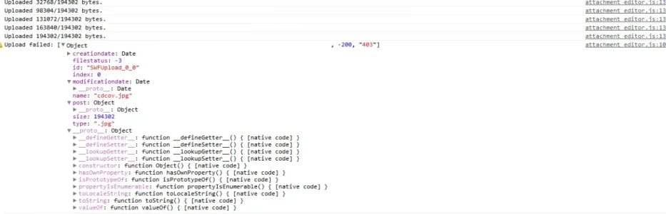

Seem to have a problem uploading within conversations after upgrading from 1.0.4 on my dev forum. The attachment gets to 100% then will not go any further. Have tried the same 3 attachments on a topic and they work without issue.#

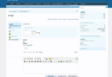

At least on my dev & test boards its running fine.
Any debug infos? (I'm testing attachments via=>
1. disable browser js
2. try to upload the file
this will throw errors which aren't thrown with js support^^)
or use an php debuger
Disabling browser JS is the best recommendation for debugging as ragtek says - at least disabling the Flash uploader via the options will help too.

I dont get this error when on flash uploader, just the 100% freeze issue. JS console showing the following. Gonna disable JS now see if I get any further to sussing it
Think this has something to do with a modification, will come back when I know more. There was a modification for the same purpose being used on the dev site for testing.
