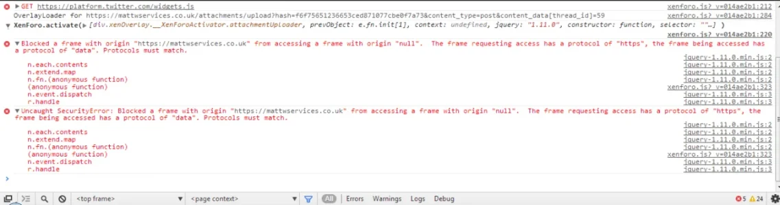

R rdn Well-known member Feb 18, 2014 #1 This is the error on my console: To replicate this: Upload a file larger than the Maximum Attachment File Size With an extension not listed in your Allowed Attachment File Extensions The Browser will just keeps on loading with that error. Is this a bug?

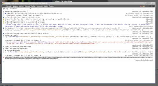

R rdn Well-known member Feb 19, 2014 #7 I don't have an error on console but Page keeps on loading with Uploading 0% status. Upvote 0 Downvote
MattW Well-known member Feb 19, 2014 #8 Can you reproduce it on my site? I'm running the same set up as you pretty much. Upvote 0 Downvote
R rdn Well-known member Feb 19, 2014 #9 MattW said: Can you reproduce it on my site? I'm running the same set up as you pretty much. Click to expand... Yes, I can re-produce it on your Site: Upvote 0 Downvote

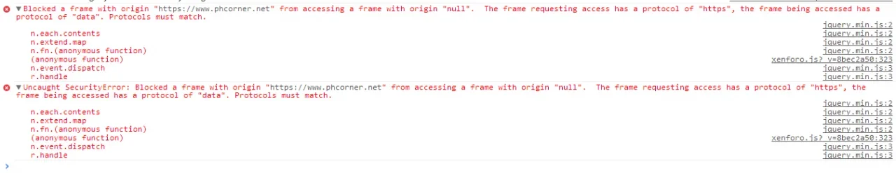

MattW Well-known member Feb 19, 2014 #11 Googling the error comes back with a specific problem with Chrome http://stackoverflow.com/questions/17950598/using-iframe-with-local-files-in-chrome Upvote 0 Downvote
