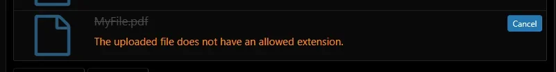

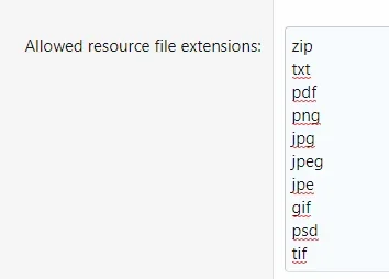

So when attempting to attach a pdf file to a resource, I get an "The uploaded file does not have an allowed extension" error. However, pdf is definitely in my allowed resource file extensions list:

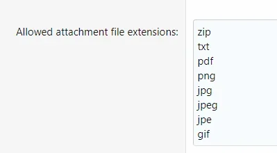

It's also allowed in regular attachments:
Yet, here it is:

Strangely enough, I have the same issue with zip files. If I add them as the actual Resource file in the initial creation of the resource, it goes fine. When I later on edit the Resource, and then attempt to add a zip file, I get the exact same error about allowed extensions.

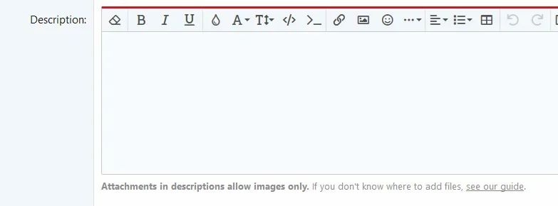

This isn't actually an issue, but it is confusing. They prevent you from uploading attachments which are not images to the body of the resource so people don't mis-use it. The resource file itself should be selected above this from the "Uploaded files" option. The text is "Type" and I personally recommend changing the phrase 'type' to say something like "Upload Resource".
And 'Attach files' for the description should get it's own phrase which says "Attach images" or something to that effect.

bingo I was about to say the same thing! A small change to communicate the difference between attachments and resource uploads would solve this. If I'm dumb enough to get confused then my members are hopeless!
