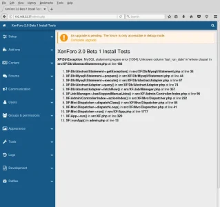

When attempting to upgrade from Beta 1 to Beta 2, I'm getting this error...
XF\Db\Exception: MySQL statement prepare error [1054]: Unknown column 'last_run_date' in 'where clause' in src/XF/Db/AbstractStatement.php at line 183
  1. XF\Db\AbstractStatement->getException() in src/XF/Db/Mysqli/Statement.php at line 34
  2. XF\Db\Mysqli\Statement->prepare() in src/XF/Db/Mysqli/Statement.php at line 44

After a few attempts, the upgrade is running. But, I'm don't know what changed that it started without error.
Before it started running, the upgrade system would take me back to the main admin screen and that error was displayed when it did.

After uploading files, the prompt to upgrade appears in the admin window with the error displayed.

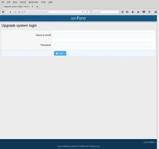

I click on that and I get a login prompt.
After logging in, it takes be back to the main admin screen with the error displayed.

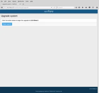

Click the link again and the upgrade process runs.
Ok, here we go...
After uploading files...
Click "Complete upgrade"...
After login...
Click "Complete upgrade" again...
After that, the upgrade runs.
