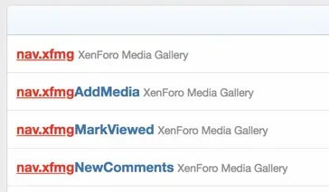

If you edited the navigation entries directly in the navigation system with debug mode enabled, then this is expected. When you do this, you are editing the master version of the phrase which, of course, is replaced on upgrades.
You just need to translate the existing phrases for these items. Some of which are listed in this screenshot:
Not sure if this is what has happened, but don't assume that every add-on template of phrase will have the same prefix (such as xfmg_).
Certainly with the case of translating an add-on's phrases, you just need to filter the phrase list by the add-on, without assuming any particular prefix might be used.
