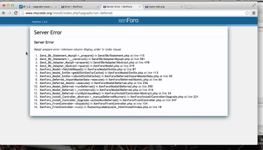

I was upgrading to Xf 1.3 this morning and encountered a server error when I tried to complete the install. I started reading and I was thinking it was due to the smiley manager addon I had installed.
I went and reinstalled the 1.2.5 version I was previously running. I went and logged into the admincp and went to uninstall the smiley manager addon.

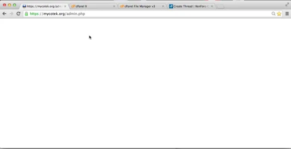

This is what I am now getting now when I try and access my control panel.

I see a blank page, is there any way of seeing more details to identify the cause of the problem?
A blank page is sometimes due to a suppressed error. Edit the library/config.php file and add the following:
PHP:
ini_set('display_errors', true);
Or if you are on an Apache server, add this to the .htaccess file:
PHP:
php_value display_errors 1
http://xenforo.com/community/threads/frequently-asked-questions.5183/#post-282417
Yea, all that I get is a blank page. It is as if there is no admincp at all..
I tried doing both of your suggestions, together and individually, and it still doesn't show the errors. I am running apache if that helps,...

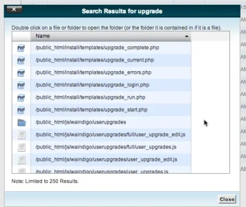

I can't seem to find inxex.php?upgrade
I also don't know how I would go about rebuilding it?
This is what I come up with when I search upgrade..
