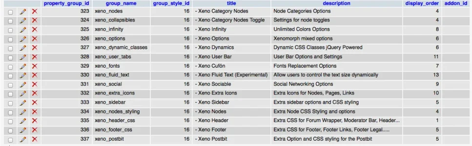

I think there might be more records there than is being shown...
If Brogan is on the right track - and I have no idea what else it could be - then this query might reveal a record without a group_id number:
SELECT * FROM xf_style_property_group WHERE property_group_id = NULL
Or
SELECT * FROM xf_style_property_group WHERE property_group_id = ''
Or
SELECT * FROM xf_style_property_group WHERE property_group_id = 0
Thanks Chris and Paul, I'll do some more digging. All else fails, I'll wipe the DB and do a clean install...it was just phantom data from an old install that I used simply for convenience.
