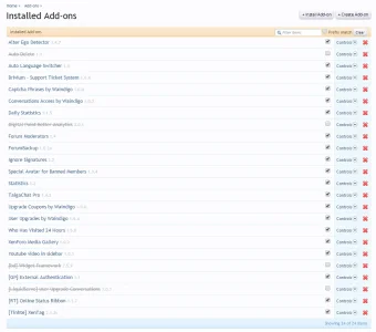

After Upgrading your two addons I do get this:

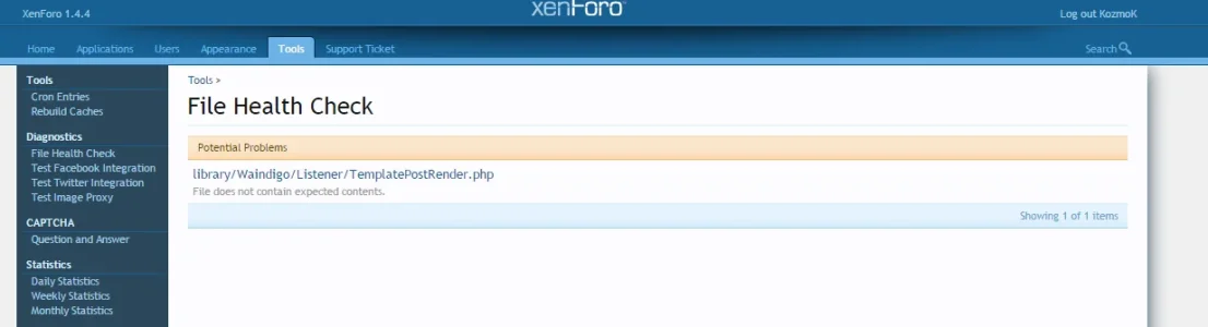

Don't worry about the file health check. You must have a really old Waindigo add-on installed.

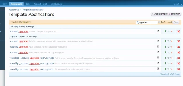

Can you look in Appearance -> Template Modifications and see if all the template modifications for this add-on are being applied?
Thanks for helping me out. FYI that is the TemplatePostRender.php that is contained in your last UserUgprades Addon - I checked, and verified.

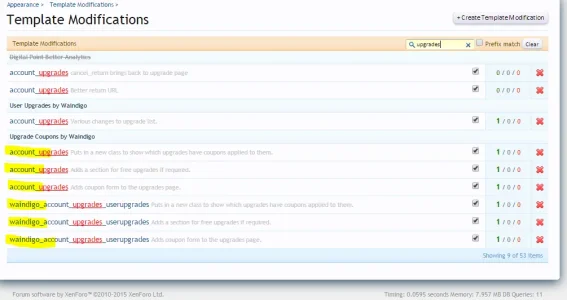

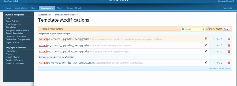

Here is the modifications I see for all "waindi"
Looking at your template code

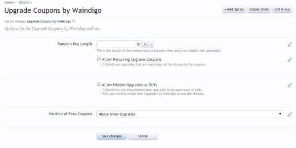

In your options for coupons, I only see "waindigo_upgradeCoupons_freeCouponsPosition"
I dont have any free coupons.
I dont see a "xenOptions.waindigo_upgradeCoupons_couponFormPosition"
Also, in your free coupons code, its "above" and "below"

Yes they are there.
