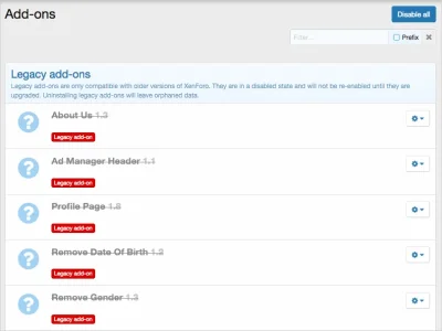

I would like some clarification, if I uninstall a legacy add-on will any database data associated with the add-on be deleted from the database?
It won't. XF 1 Add-ons do have XF 1 uninstallation code which can't be executed in a XF 2 environment.

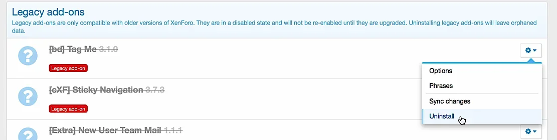

So what happens here surely "uninstall" means uninstall from the database (I assumed orphaned data was referring to orphaned files/folders in /library or /js etc.):
This notice should therefore be clearer and say to not leave orphaned data (in the database) you must have previously uninstalled in xf1.
The add-on entry is removed and that's essentially it.

Any data that is stored in the DB in a way that's associated with the add-on (so things like options, permissions, templates, etc) will be removed.
Excellent, so legacy add-on which do not have an uninstall.php file will be cleanly uninstalled.
I suggest the following phrase:
Uninstalling legacy add-ons will leave orphaned data.
be changed to something more descriptive, for example:
Uninstalling legacy add-ons may leave orphaned database tables and or schema changes.
