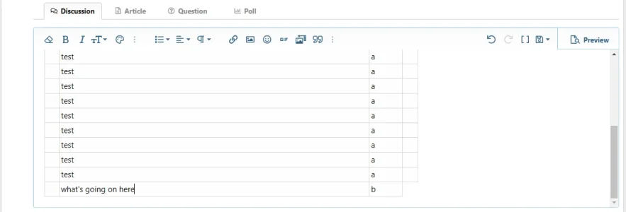

When I copy the table into the editor, it looks fine:

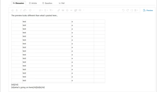

However, when I hit preview, it changes the bottom line...
When I submitted the post, it (obviously) took the preview version of the table, which is 💩. You can see the result, after the thread was posted, here: https://xenforo.com/community/threads/table-copy-paste-test.229188/

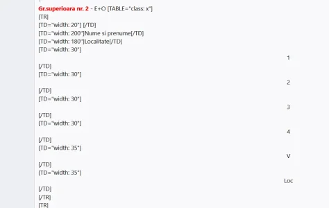

I'm also facing this issue... I have pasted in from Excel and Sheets - errors as shown throughout this test thread.
But removing formatting get's closer but still not usable.
