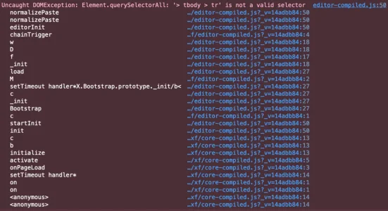

I also attached a picture of the console log.
This previously worked before upgrading to 2.3

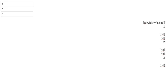

I've attached a picture of the sheet itself.
Interestingly, I just noticed it doesn't work here as well when I paste it in. I have checked my other xenforo site which is still on 2.2 and it's working fine.

col B seems to be the issue.
aI
bII
cIII
dIV
[td width="48pt"]
1
[/td]
[td]
2
[/td]
[td]
3
[/td]
[td]
4
[/td]​
I noted it only did it on NUMBER cols (as they are right aligned. throwing the RIGHT bbcode in there causes the issue
aAI
bBII
cCIII
dDIV
all letters is ok so long as you don't align it.
As a stop gap, set the numeric cols to left align in your workbook and paste again

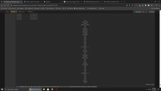

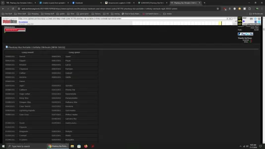

I've had trouble with it messing up tables after the update myself. such as...
Original: https://web.archive.org/web/2021100...ortable-2-infinity-cwcheats-npjh-50332-a.html
2.3's version.... https://www.vgcheat.com/threads/phantasy-star-portable-2-infinity-cwcheats-npjh-50332.181792/
One is from archive.org where vbulletin displayed it properly, the other is after the xenforo 2.3 update. Some tables have similar issues.
It's important to not also that xenforo 2.2 did not have any issues, and this seems to have occurred with xenforo 2.3 update.
Even test threads here suffer from the same issue.

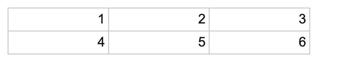

Paste from Google spreadsheet looks fine at first
Here is screenshot:
But this is how it renders
