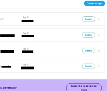

I have created in one of my Twitter developper accounts now different apps for different XF forums of mine.
Each forum with its app has a unique Name, image, API and a unique API secret key. This is how Twitter offers it.
But as soon as I make the test in XF/ACP/tools Twitter test, it connects with the wrong app name. It only takes the app name of the developper account, although the API used in XF is from the other forum.
