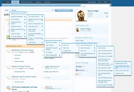

So we have had an extended menu on AVForums for years where people can drill down a fair way into the sub forums to quickly get to the area of interest.
and I was thinking about how we could implement this into Xenforo when we move in August.
Going forward the new header will have more of an emphasis on editorial and the forums will be just one of several main menu options, making the job even harder.
Then I had a thought that maybe we could use the breadcrumb as a way to navigate through the nodes.
Hover over one of the breadcrumbs in the trail and the whole list of siblings drops down. From there it's possible to highlight one and its children pop out to the right in another list. And so on.
I created a mockup. Obviously it would need to be styled to look much prettier.
It would allow for relatively fast navigation to every node in the forum from every page, and would, of course, need to use the jQuery system detailed here.
Anyone think this is a good idea? Or is it rubbish?

I have this hackishly worked out (the jquery submenu thingy displayed on hover of a breadcrumb item) but my problem is that I don't know of any way other than manually hard coding every entry or scraping to get the entire node tree and have it available to my script for use of listing menu items.
Basically for my script to work at this point you would have to hard code all node info into the script or scrape bc links to get the child nodes for the list.
I do have an idea that I POC'd (for a standalone jquery menu I built) to allow for all submenus to display without going screwy on narrow widths while responsive, it adds an extra click to the whole thing as far as use goes but it is the only way I could find to not sacrifice displaying all child nodes on node hover which is the whole point of this thing...responsive or not imo.
I see that you are going live in August with XF and I don't know that I could finish it by then (trying to get all public nodes is what is stumping me.) or if I will be around at that point due to personal issues. However if I can do what I have at this point (and I am no God)...I am sure you will find someone that can get this done for you, which is great because this is something I think will be very useful for the way certain visitors browse.

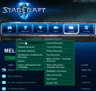

Interesting idea. At first sight I thought it was rubbish, but when I tried the Starcraft breadcrumb then I was sold.
I think this kind of navigation has multiple benefits. Firstly it allows the user to quickly switch one breadcrumb element for another on the same level.
Secondly it allows the user to navigate deep to whatever node the user wants to go.
I would not allow an infinite depth of node levels. As you have illustrated that can result in a chaotic chain of menus which will go out of screen.
