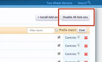

Having a master switch for addons in ACP would be really cool btw or a 'select all' checkbox.
Brogan
XenForo moderator
Staff member
It's not a problem doing it that way and alerts from the core functions would still work.
It's just not needed when doing general troubleshooting and is typically for more drastic issues.
There is in 1.5.
