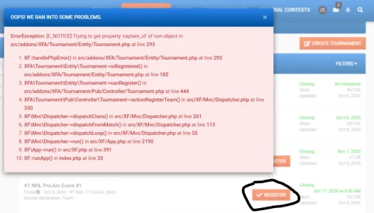

I have the XFA Tournament Add-On, when I try to register for one specific tournament I get the following error. It is very important that I resolve this error ASAP, as the event is taking place this weekend and people are trying to register.

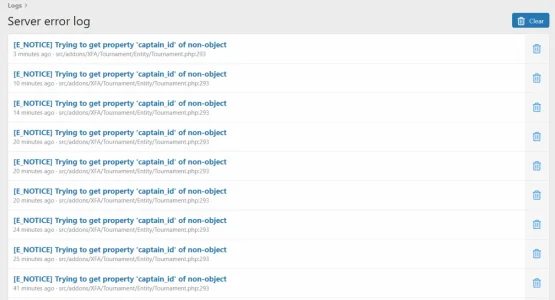

The part of the code in which the error occurs is due to the incorrect type of the tournament and due to the lack of the add-on https://xenforo.com/community/resources/xfa-roster-xf2.6188/ (perhaps the developer should have checked first, is this add-on installed...)

Try to find the table xfa_tourn_tournament in the database of your forum, and in it a record with data about this tournament (as I understand it, with id = 9), then replace the value of the type column with 'solo', 'team' or 'free_input', depending on the type of this tournament. I think this will help.
