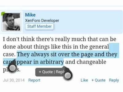

Browser issue Tooltip is hidden when selecting a paragraph
I don't think there's really much that can be done about things like this in the general case. They always sit over the page and they can appear in arbitrary and changeable places.
Maybe somehow let the users to choose if they want to copy/define the text or select it?
The "QuoteMe" add-on overcomes this by a button that disabled Apple's tooltip and enables quote selection.
Not sure if this is the best method here, maybe there are other solutions to this. It looks like Apple's tooltip is only shown on the top or bottom, on the blue selecting dots. There are two more dots on the sides, so maybe the code can be manipulated to show Apple's tooltip on one of the sides instead on its current place (or vice versa, to do it with XF's selecting quote).
But then I'm not sure how it would affect Android devices.
Does the pop-up have to appear attached to the (end of the) text?
I struggle most of the time to use the Reply option unless I zoom in on the screen so that the selection marker doesn't overhand the pop-up as much.
Maybe the pop-up could appear somewhere outside of the selection? That way it wouldn't be obscured by the various shaped selection markers.
As far as I can tell, the closing icon for all touch screen devices is below the line of text.
One possible solution therefore would be to have the tooltip above the line of text.
Unfortunately it does obscure the selected text.

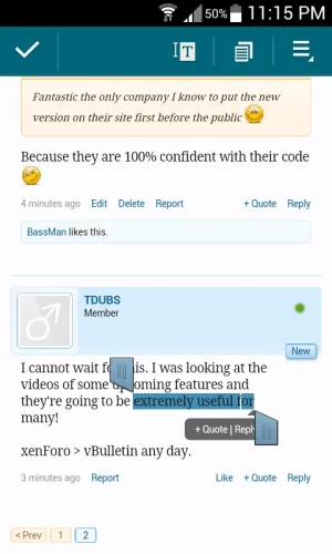

I can confirm this is also an issue on android. The end marker obscures most of the reply option in all cases I've tried so far.
