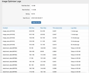

@truonglv - why did the numbers sequence change? Also, how do you know when its done, when the time spans become larger like in the image and are now listed as image proxy as apposed to attachment. Thanks.
189599
It is more technically for explain. With limited english i cannot give an exact explain.
For simplest: before run command optimize i put an flag and when command done it is substract between end with start time.
If you look at the tl logs (admin.php?tools/io-logs) in one window and then look at attachments (admin.php?attachments/)
you should be able to correlate the latest attachments size with the size new size in the tl-logs
If the latest in the tl-logs is same as most recent attachment it is current
