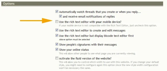

As I've repeated several times, and even wrote in the addon options, I don't recommend to use TinyMCE with mobile devices (except tablets). Now in the next version of this addon, for the most stubborn of you who still want to activate TinyMCE on mobile devices, I will an extra option that will let members to select if they want to use or not TinyMCE on their mobile (not tablet). But I insist again : on mobile devices, users don't need as many buttons as on desktop version. So the unsupported version of the MarkItUp editor is enough.

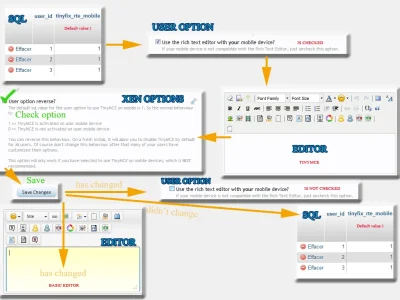

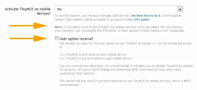

  • For those who selected to use TinyMCE on mobile devices (not recommended), there is now an option for your users: they can select to enable or disable it. So if you use TinyMCE on mobile devices, this option is automatic now. By default it will be enable for all users (to keep the previous behaviour). But there's an option to reverse this behaviour (see inside the options)
To update: upload files and import XML file
If you...
I have Activate TinyMCE on mobile devices? set to NO.
Should I checked User option reverse also?
To have the value = 0
