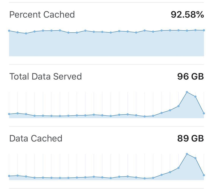

:rolleyes: I recommend DigitalOcean, Vultr over OVH, pair with Centmin Mod by @eva2000 :rolleyes: Use everything Centmin Mod supports: pagepspeed, brotily, pgo, dual ssl, and maybe and extra layer of CloudFlare protection :whistle: I am using those combination in my community and the results is pretty good, my users love the response time even the server isn't a local provider, with the cache + protection from CloudFlare, server cost reduced much since from my testing 1000 user only take about 300 MB of RAM. About server management, I have 0 knowledge on it, but thanks to @eva2000 his support and documentation.

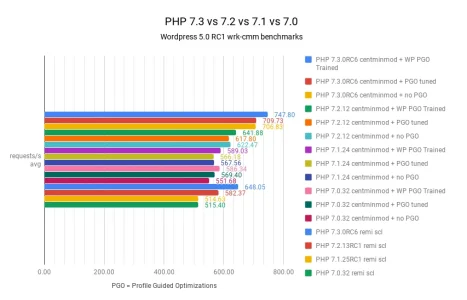

Yes Centmin Mod LEMP stack is only known LEMP/LAMP or control panel of any kind to support PHP 7+ Profile Guided Optimizations to boost PHP 7 performance by another 5-40% depending on PHP code paths as well as have options for end user configuration for PGO script training.
Benchmarks for PHP 7.3 vs 7.2 vs 7.1 vs 7.0 for Centmin Mod LEMP stack with/without PGO training
  1. https://community.centminmod.com/th...1-vs-7-0-php-fpm-benchmarks.16090/#post-68855
  2. https://community.centminmod.com/th...1-vs-7-0-php-fpm-benchmarks.16090/#post-69010
Centmin Mod PHP vs Remi YUM Repo provided PHP
