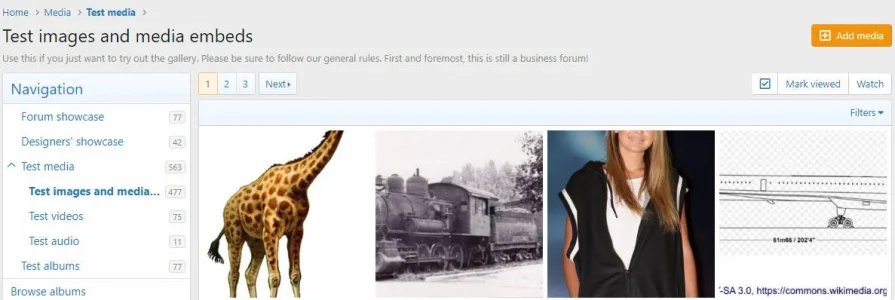

Here is what I mean when users upload photos which are both landscape and portrait format to the media gallery:
I would really like it if there were an easy option to scale images down to thumbnails without cropping.
example of thumbnails when media gallery contains mixed portrait and landscape format photos.jpg
