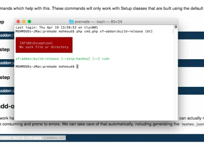

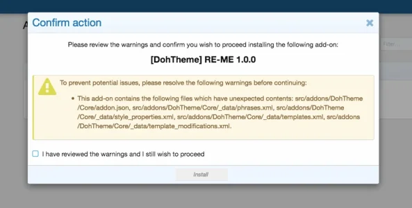

I asked a developer to make me an add-on and after finishing he had a life problem so I tried to make some changes to add-on files like changing style properties name and a name of a template but when rebuild or re-install gives me this :
How to fix it?
Regards
You click the checkbox and click "Install".
The changes are changes you know about, so there's no need to be concerned.

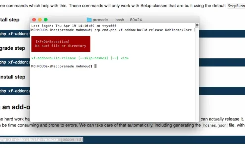

Yes that's right, but this add-on will be available to my clients and I don't want to appear to them
You seem to have typed the add-on ID as [dt]. You don't need the square brackets, though also make sure the add-on ID is exactly correct. Based on your earlier screenshot it looks like the correct add-on ID is DohTheme/Core.
