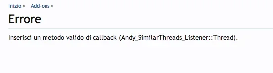

I'm on a dedicated server (i5 quad core, SSD and 16Gb di ram) and fiber cable internet so I should not have timeout issues... and the issue not seems related to add-on weight...

Looking in the add-on file structure don't seems that this add-on had weird things...
With Chris add-on, no issues...
This is the reason because I report here :)
