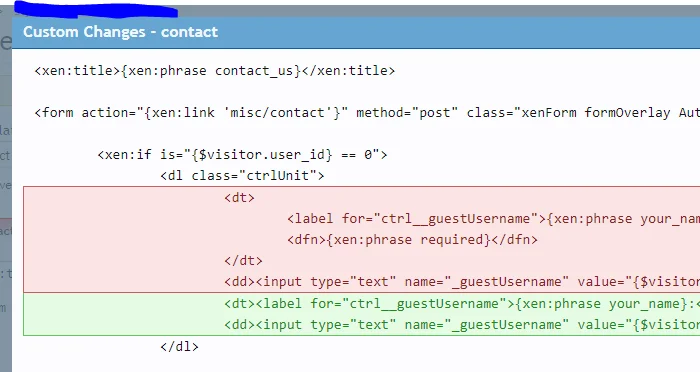

Buttons like this I understand:
but there are not present in v2 anymore, are they?
Diff-views like in SVNs or in this: https://www.scootersoftware.com/features.php?zz=screenshot&shot=TextCompare I do understand (and use like twice a week) but this isn't available either?
And what is the message "The custom template is out of date but has been edited more recently than the parent. Merging can only be done by hand." suppose to help me? PLEASE Show me two links along with this to the one and the other version I have to merge.
