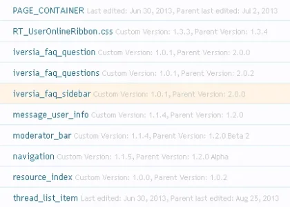

I don't know if this was asked before, but why can't we merge changes from templates older than 1.2? It's just because they don't have a history record or something else?
I am doing this right now and the only thing I get when I try to merge changes is „No previous version of the parent could be found. Merging is not possible.“
You can't merge if you import a style from elsewhere. We use edit dates to determine the version which your template is based on and if you import, that's not possible. (This system allows you to merge between parent and child styles.)
The other alternative is that the template history has been removed, but by default this is after something like 60 days.
Well, the style obviously has all the data about template versions and as far as I know it wasn't imported from somewhere else after 1.2 upgrade, it was there during the upgrade.
But why can't we just create a new history record „on the fly“ when merging changes? In fact, I've never used TMH to upgrade templates from 1.1.5 to 1.2, on any site, so I did all the changes by hand and thought that <1.2 is just not supported.
