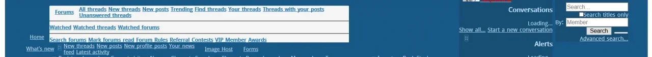

Template broken after upgraded from 2.0.12 to 2.1.1, Please let me know that how to resolve this issue? Also this issue happened in Admin CP.

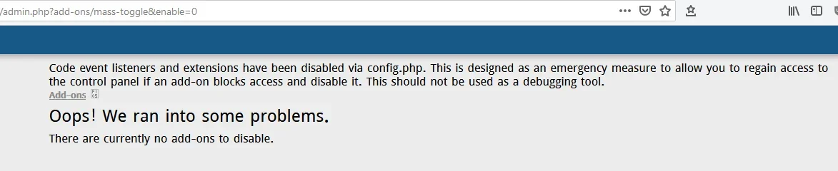

I have opened Disable all to new tab and get this.

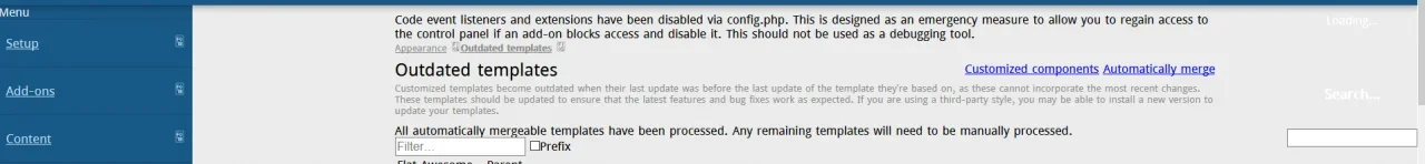

The same thing happened to me when I was upgrading because I hadn't updated my style. Once I updated my style by Dohtheme it fixed the issue. It's an outdated template issue. I also upgraded from 2.0.12 to -> 2.1.1
Really just merging outdated templates would have probably fixed it
Well, it was happening with the default style, and I gather everything was so out of whack that it was hard getting to where he needed to get to and making any changes.
