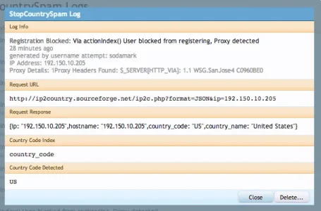

Cool, here is the guy who was just turned down.
He's USA and San Jose....but I assume lots of the mobile devices may use proxies of some sort....
So, what should I change to loosen this part up a bit?

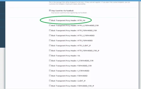

They are using a web service gateway (so possibly via mobile), and this is being added to the http_via
So turn off this one:
However, if you're worried about other networks, I would turn all of the proxy options off
- Some users will use proxies and not know about them

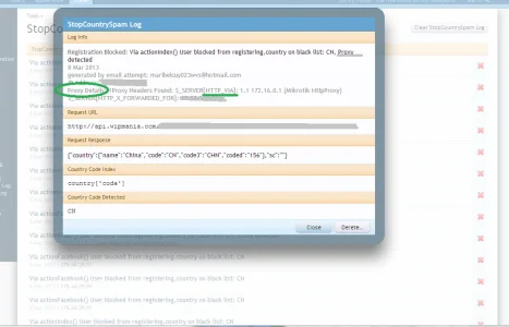

Have a look at your response, found here:
admin.php?stopcountryspam/logs
click on the row to see why you were blocked
1)
If your country is stopped from registering (is XX or some other country reason)
Make sure that URL really works, simply copy the response url and paste it into your url to check what happens, for instance:
http://api.wipmania.com/114.32.48.238?k=xxx-yyyyyyyyyyyyyyyyyyyyyyyy&t=json
If you are using the correct key, it should return the country code like this:
{"country":{"name":"Taiwan","code":"TW","code3":"TWN","coded":"158"},"sc":""}
If you are using an incorrect api key (as above), or no API key, it will return the country code like this:
TW
does it?
If you can copy and paste that url to me and send it via private conversation, I'll probably be able to tell you what the issue is
2)

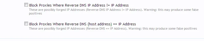

If Proxy Issues are found:
Clicking a row in the logs will tell you the exact reason a user is block (since this doesn't just stop countries but can be used to block proxies too), you can switch off all of the proxy options.
Some IPs and some host will always send proxy-like data in the headers (but this is not the norm). Once you know which one is preventing the registration, turn off that proxy check in your StopCountrySpam options
