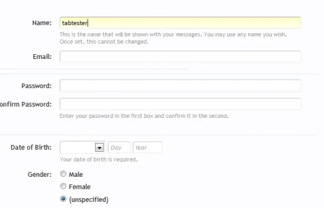

Another thing I noticed is that in firefox I'm seeing 2 fieldset borders (thin blue lines) after the username and password. I imagine this has to do with hidden fields. This doesn't happen in Chrome though. More annoyingly, due to these hidden fields I'm not able to properly tab to the next fields. I'm not sure about most people, but when I'm filling in forms I tend to fill in the field, tab to the next, fill in, tab, and repeat until completed. It can be a hassle when you need to press tab 3 times to get to the next field.
After realising that tabbing appears to be hitting the hidden fields I decided to try randomly typing something while tabbing into them and was detected as a bot with altering hidden fields. So if a user is typing in his fields relatively quickly and doesn't pay attention to the fact that he didn't actually tab to the next field correctly and starts typing, they'll end up being detected as a bot. :S Anyone else able to reproduce this?

Tabing is a bit unavoidable
But, if they do tab and access hidden fields and if they then fill in those hidden fields they aren't blocked permantantly,
they're told they've been detected and redirect to the registration page to re-attempt the form (and the hidden fields are reset)... I can't prevent tabbing ( I can't really set a tabbing order, since this could then be used by bots)
I've found that there are only 3 fields that are accessed by tabs (out of 24 hidden fields) and that's because they are not diplsay:none, but hidden/shrunk. For those 3 fields, I can set them so they can't be selected (so can't be changed by humans). That should prevent humans changing the values of these particular hidden fields and ever seeing the message for bots.
Having various different methods of hidding fields is part of how the honey pot works (So I don't want to hide all of these fields with the same method)
I'll look into the cosmetic blue lines in FireFox... (do you have a screen cap, I can't see them in FireFox myself)
oh wait.. looking at the above screen cap again, I do see them, the 2 faint lines after the email field? (there should only be one)
... okay, I've fixed the url issue for the contact link (for the bots warning message)
... I've made it so that the tabbed fields can't be altered (but you may sometimes have to tab a couple of times to get to the next field, this can't be avoided)
... I'll look at those blue lines now

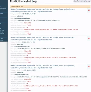

In a separate issue, I noticed in one of the logs:
Basic Proxy Detection: Proxy Headers Found: $_SERVER[HTTP_PROXY_CONNECTION]: Keep-Alive
Is that server variable not being parsed, or is that correct?

That is correct, that is the proxy header that was detect. The bot is using a proxy, and it's a traparent proxy...
Most bot proxys will be detected as:
Possibly Forged IP Address, ReverseDNSIP (somehostname) != ipAddress (xxx.xxx.xxx.xxx)
Or
Possibly Forged IP Address, ipAddress (xxx.xxx.xxx.xxx) == ReverseDNS (xxx.xxx.xxx.xxx)
These 2 methods seem to pick up about 70% of the bot proxies.... and these are often Anonym / High Anonym (not transparent)
For the transparent proxies, I check the header for the following:
'HTTP_VIA', 'HTTP_X_FORWARDED_FOR', 'HTTP_FORWARDED_FOR', 'HTTP_X_FORWARDED',
'HTTP_FORWARDED', 'HTTP_CLIENT_IP', 'HTTP_FORWARDED_FOR_IP', 'VIA',
'X_FORWARDED_FOR', 'FORWARDED_FOR', 'X_FORWARDED', 'FORWARDED',
'CLIENT_IP', 'FORWARDED_FOR_IP', 'HTTP_PROXY_CONNECTION'
If any of the transparents are found, I list them and let you know with the following string:
Proxy Headers Found: $_SERVER['header_index_name']: header value
In your case
The transparent proxies are fairly rare (they kind of defeat the object of using a proxy, since they are easy to detect), but every now and then one pops up. They're almost always free and available, so if a bot user wants to cut corners and not spend any more money / uses a bad list of proxies then sometimes they use transparent proxies (often without realising)
The $_SERVER is not a variable, that's here on purpose, since "HTTP_PROXY_CONNECTION" is a $_SERVER index, and "Keep-Alive" is its value
