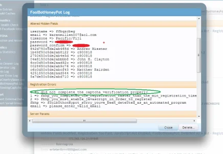

I'm using the built in Q&A captcha as well as this. Does this mod record if the bot failed the captcha? Can't see it anywhere but I might be looking in the wrong place.

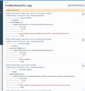

yes, go into the log section (Admin CP >> Tools >> FoolBotHoneyPot Logs)
Then for each bot, click the row. You will get something like this:
If the CAPTCHA fail is not present in the registration errors, then the bots are getting through your CAPTCHA
If you have lots of CAPTCHA, then you will need to go through a few of these. You could take images of your text and use that with customImgCaptcha (but if you are going to take images, you may as well use something unique that is not text)

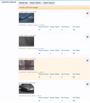

I use CustomImgCaptcha with custom images, foolbothoneypot then tells me for each CAPTCHA how many times humans have passed/failed it and how many times bots have passed/failed it:
(I then know when I need to change my CAPTCHA)
