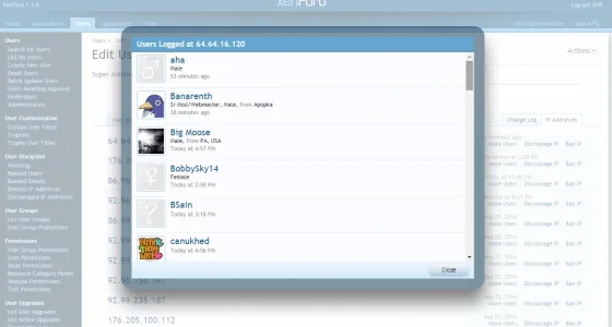

My forum admin told me that when he looked at the IP of new members they were looking similar so he searched for this IP to find if there are others from the same IP and few others genuine members were listed. It looks like the forum is assigning the same IP to everyone now.
Update: Hi @tenants , I just found out that my server IP 64.64.16.120 is being assigned to all logged in members. I don't know how.
I recently got my hosting company to install SOAP client on my server. Could this be causing the issue?
This is probably an issue with nginxcp and the rpaf module not passing the correct IP back to apache. If the hosting company rebuilt apache via easyapache, you need to re-install nginxcp again.
