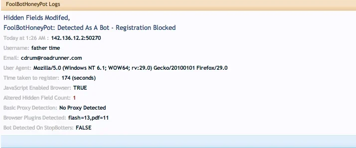

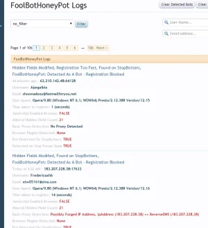

It works out of the box, you don't need to change any settings. Just look at the logs in the ACP and you will notice that it detects the bots when they attempt to register
It gives quite a lot of evidence, such as:

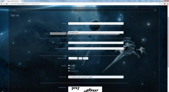

Hey--
We've been having a lot of success with this add-on in terms of blocking bot registrations. :D
I noticed however that in certain styles like Space by Xencrea where the background isn't solid, you can see duplicate fields in the background. Is there any way to hide those?
Hey--
That's interesting, I'll take a look at non solid backgrounds before next release. I think I may have already fixed this (since that hidden email field should have 0 width & 0 height)

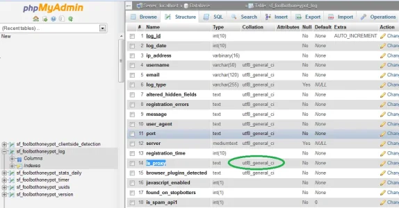

Incorrect string value: '\xD3RIA (...' for column 'is_proxy' at row 1 - library/Zend/Db/Statement/Mysqli.php:214
This hasn't been seen before, I wonder why now (it seems to be very rare)
For 'is_proxy' the only place a non string value could come from the user is from:
$ReverseDNS = gethostbyaddr($ipAddress);
$ReverseDNSIP = gethostbyname($ReverseDNS);
But the datawriter will prevent any non strings from getting in, so to be honest @DaiAku this sounds like a collations issue
If you log in to your database (phpmyadmin) and check the collation for the table sf_foolbothoneypot_log (column: is_proxy) what does it say, it should say "utf8_general_ci"
That's interesting, I'll take a look at solid backgrounds before next release. I think I may have already fixed this (since that hidden email field should have 0 width & 0 height)

Hi I've checked on the server side in phpmyadmin and the collation is uttf8_general_ci as it should be... any other thoughts?
Are you the same person / admin the same forum as @DaiAku (or see the same error "Incorrect string value"?)
Has this error only ever occurred once?
He is an admin on the same sight as me and we manage the site together. Sorry, we should have been more clear. We have only seen this error once.

Hello :)
I'm just curious - we have confirmed that this user is not a bot, but he was able to alter a hidden field... any idea how this might happen? Not sure what to tell the user to allow him to register. Maybe an "autofill" issue or something? I'm a newbie when it comes to this stuff ;)
