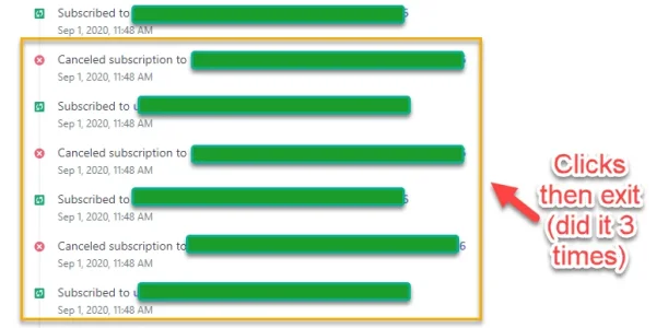

So a click on the Upgrade button will be logged as a subscription and when they try to exit the billing modal, that gets recorded as a cancellation. Each click on the Upgrade button and each click outside of the screen (to remove the Stripe popup) is being counted as a Subscribe and a Cancel.

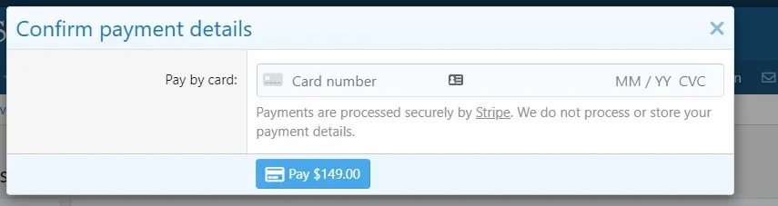

I created a test account, attempted to click on the Upgrade buttons 3 times and during those 3 attempts, I will not enter anything in the "Confirm payment details" modal and only click elsewhere on the screen to remove the billing modal.
Here is what gets reported to Stripe:

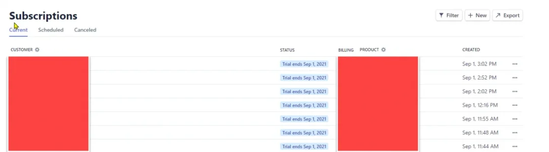

First of all, Stripe is now reporting false data to us. When we checked for a list of current and canceled subscriptions, the same customer who didn't fill out their billing details during the first attempt was listed under both sections (Current customer and Canceled customer). When we want to export our Stripe reports, we wouldn't be able to tell if this customer is actually a current subscriber or has already canceled his/her subscription.
Secondly, anyone who only clicks on the Upgrade button will also be reported as a subscriber, even if they don't fill out their billing details. This gets added to the Stripe's Subscription page. Again, when we want to get a list of current customers (subscribers), this person who didn't actually pay will be included in the report. And we wouldn't be able to tell if he has paid or not unless we look him up in our forum or Stripe's dashboard.

Jumping right in here, based on the logs associated with the cancellations you've outlined, the subscription.cancel API call was done through the API. For cases such as these, I'd recommend having a look at your integration. Specifically, the code that is executed when clicking the upgrade button.
I assume they're talking about XenForo integration with Stripe.
Update #3: Further reply from Stripe support
As mentioned previously, what may be causing the issue here would be the code that is executed when you or your customer clicks the purchase button. I'd suggest to have a look at your code for what happens when that button has been clicked.
As far as we can see here, based on the logs, the action that is taken during the timeline you've specified is to cancel the subscription and to subsequently create a new subscription. In order to resolve the issue, we'll need to have a look at the code to identify any underlying issues with this.

Based on what I can see through the video you've forwarded (also provided this video to the XenForo support team already) is that there doesn't seem to be any error handling when the there is no input within the text boxes for entering payment details (i.e. the customer is not prompted to enter in any information or there is no prevention of the progression).

We have changed this for the next 2.2 release. It's a pretty significant internal flow change for Stipe when doing recurring subscriptions. We'll now only create the subscription once we have a payment method. (If that payment then fails or requires something like 3D secure which isn't completed, the subscription never leaves "incomplete" in Stripe and it will be removed in approximately 24 hours. You can filter these out in the Stripe dashboard.)
