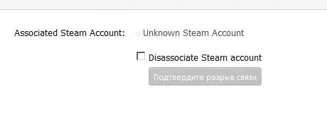

Ya I get an Unknown Steam Account as well, which I find it strange, unless Valve did some modifications of it's own in the past couple of days haha.
I've checked and found that I've got Unknown Steam Account too, login and message user info part work fine ...

It's returning unknown steam account because the xml data it's getting is empty. I'm going to try to change it over to the API key for my website and have somebody test it for me. I'll report back later today.

Okay, so after a little breather I came back and started to compare what changed from 1.0.4 to 1.0.7. I'm taking this one problem at a time, so the first thing I decided to tackle was the Unknown Steam Account issue in the Steam Integration section. It seems like my second guess was right, it looks like it doesn't have to deal with rate limiting, but something with the code.
For some reason, when using cURL, it's not liking what it's pulling out. I have a sneaking suspicion it has to deal with what @AndyK reported in his error logs
So I decided to try favoring 1.0.4's version way of loading xml data
Boom, steam account names suddenly start working again and I'm not longer getting Unknown Steam Account in Steam Integration (Steam Profile badges still aren't, but baby steps). Now the only problem with this is that I don't know how important the new method of pulling XML data is over the old one. I'm not a php guru, and without any comments on the code, I can't tell if this causes any adverse effects. As far as I can tell, the getUserInfo function only deals with the account page. But obviously, the best bet would be to get the function working as intended using simplexml_load_string instead of simplexml_load_file.

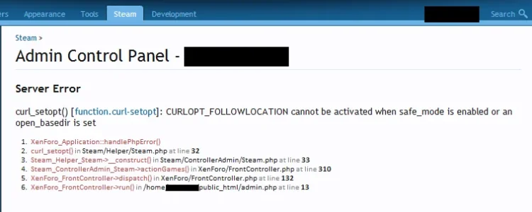

if the host has php open_basedir protection, this will not work and continue to error 302. I do have root access since my host is me, and I could turn it off on my domain, but other users might not be so luckey.

I'm also having some problems and this may be from what Bubka3 mentioned with the open_basedir enabled
Yep that's it. Alright, I'm going to revert back to the simplexml_load_file logic. Hang in there Once I get Binari0's database bug hammered out (which will help people like @Gabriel Pinho) I'll release the addon again.

Tried and tested a open_basedir compatibility fix. Here's the file. All you need to change @Qwk86gn is upload the following file (and overwrite):
upload/library/Steam/Helper/Steam.php
to
