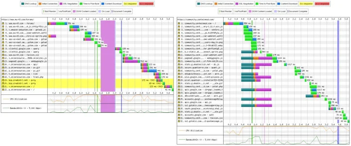

Not trying to keep harping on eva's site, but I think @rafass is right in saying it's the gold standard, so here goes...
On the left is a typical Webpagetest waterfall from my site, on the left from eva's. Both are using Chrome 46 (http/2 support), cable connection, and a relatively close test location.
My total page size and number of requests are both significantly lower, but eva's start render and speed index are consistently better than mine.
Am I reading the above waterfalls correctly in saying that the key differentiating factory is that eva's site is concurrently serving 16-20 resources, while mine is serving just 2-4 at any given time? And is this because of http/2, which mine doesn't currently support?
