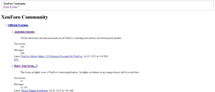

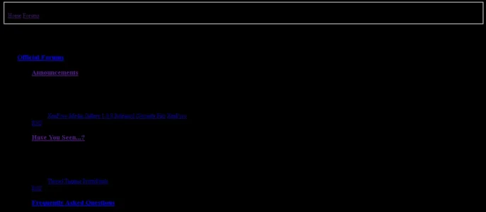

First and foremost, this is going on for months and is not an issue on my end. Most of the time when I access xenforo.com I see this:
And this:
The site loads slow and as the two pictures show, CSS and Javascript are not or partially loaded. I'm not sure myself but this could be an indicator of high load as the server fails to serve me with CSS and Javascript files. Could it be that xenforo is a target of an DDoS attack?

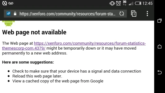

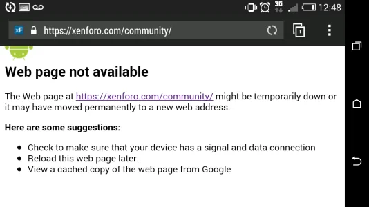

I don't get that but many day's it errors on my mobile & just won't load but other sites are fine including other sites running Xenforo. Laptop & PC are fine. Working fine just now however!
This is -again- a common problem with the "base" tag XenForo uses in all it's pages. This tag is known to have problems in many situations with all of the browsers. Just search Google.
We also encounter such problems in our server logs daily. There is not much you can do about except reloading the page or using another browser. Many of our users have complained about it and I also see this issue from time to time myself.
I was checking the forums new posts on my phone today & it happened again. I couldn't get back on although I could browse other sites fine & my own XF forum.
I'm able to access now several hours later.
Screenshot_2015-07-25-12-48-08[1].webp Screenshot_2015-07-25-12-45-14[1].webp

Here is a screenshot of the current thread. I'm not going to mess with my DNS settings just for one website.
It's unlikely to be DNS. That appears to be part of the CSS not loading properly, which would point to a network issue. I don't know of any issues in the network (in terms of SoftLayer's), so there could be something between you and them that is causing sporadic packet loss. Unfortunately, there's unlikely to be much we can really do to prevent it.
