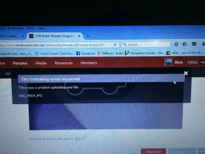

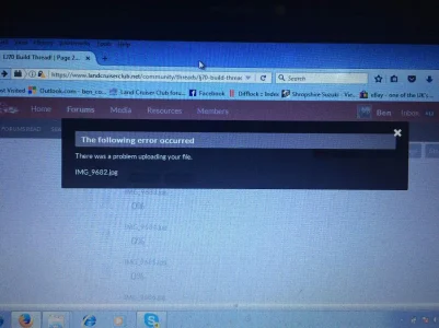

He says his next attempt gave an error while uploading a picture

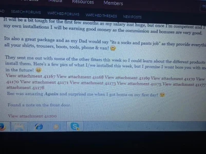

and all the previously embedded images after posting now simply said "View attachment =1234"
On subsequent posts he is still getting this this

The problem uploading a file error is, unfortunately, roughly client side. Disabling the Flash uploader may help avoid it, as Flash seems a little temperamental when it comes to variable network connections. I'd note that any attachment uploading is independent of actually submitting a post, so that error shouldn't do anything to his post content.
I can't tell what exactly I'm looking at with the "view attachments" screenshot. That is generally expected when editing a post. If viewing the post in position, that would seem to imply the attachments either weren't uploaded or aren't actually associated with the post (in this case, they may still be viewable when clicked). It's difficult to know specifically what happened in hindsight. Did he have to use the draft saving feature? Did he see the previous attachments listed when that happened? I know you asked elsewhere, but the attachments would exist in a draft post for 24 hours, so if he composed the post for an hour, there's no reason for them to have been removed.

He did not have to recover the draft, he clicked on preview and that shot, I believe is the preview.

Ok, so this is interesting - he said these two pics would not upload. He could upload before these, after these - just not these.
Yet they upload ok (DnD) here.
If you and others are unable to reproduce the issues, it's going to be due to local factors specific to that member, such as browser, connection, ISP, etc.
