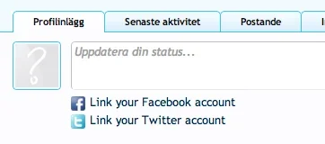

I just realized that I haven't associated my XenForo account with Facebook? Might that be the problem?
Not really...
You need to go to the add-ons options and make sure you have configured the Facebook and Twitter application keys... As per the resource description.

Maybe a stupid question, but the status update is supposed to end up in my personal view/timeline?
It will appear on your timeline, yes. You may not see it on your News Feed, you will have to go to your actual profile page.

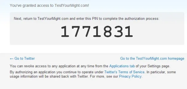

Okay, new issue but it's probably small... other members are having an issue with where to "put the code that Twitter gives them"? I didn't have to put this code anywhere, oddly... it just said linked and it works for me now.
Any help with this one? Sorry to be a pain.. :)
I have no idea what that is...
They shouldn't have to do anything with any code.
I've never seen that before.
I suspect the Twitter app has been setup incorrectly.
Could you PM me or email me a screenshot of your Admin CP options for this add on and a screenshot of all the settings from that dev.twitter.com link you posted earlier.
Maybe I'll notice something wrong.
