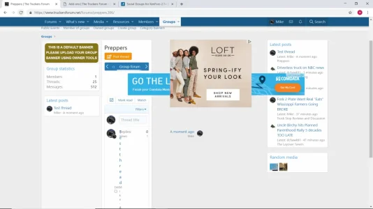

I've installed groups onto my forum. Looks fine on mobile, but looks like a disaster on my laptop. (using the latest chrome and firefox).
Any idea what may be causing this? I've tried reinstalling the add-on, default theme, etc...
It looks like your advertisements might be causing the problem. Does it display correctly if you disable them?
If it does, what positions are you using for advertisements?
Which ones?
I just added in the "container contene: above".
Messed it up immediately.
Figured it out, though.
I was using my own responsive settings for various screen sizes to prevent large ads from showing up on mobile. Somehow, this is creating the conflict. I put in a default responsive ad unit and the problem corrected itself.

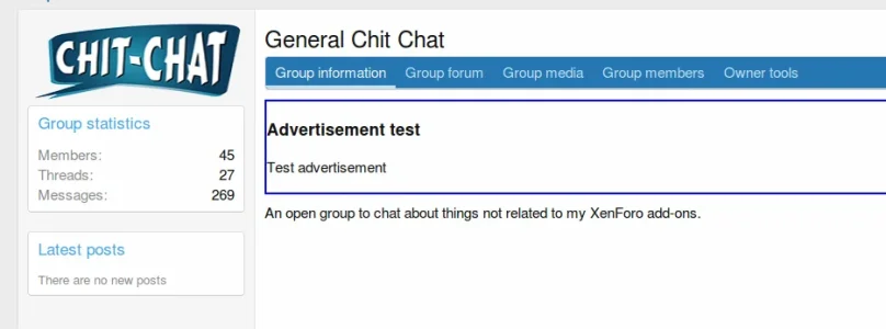

Note that there are some pages in the group system that won't display ads at this moment. The next release (which will be tomorrow) will show the ads on pages that are missing them.
