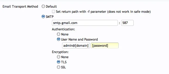

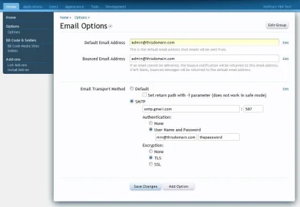

Just for posterity, I've attached my SMTP configuration screen capture from XenForo.
The only other things I can suggest is trying the different port. Google Apps specifies that TLS be used with port 587. SSL is 465. (http://mail.google.com/support/bin/answer.py?hl=en&answer=13287)
So, if you have not tried it, use port 587 in XenForo, using the TLS option.
Let us know how it turns out.
Edit: My point here, I've had problems in the past in using SSL with Google Apps. TLS has been more reliable and always works, whereas SSL just wouldn't work in some cases.
