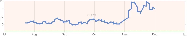

i've been reporting my Site performance for the last month hoping for to get better but without any luck
Performance overview
On average, pages in your site take 15.2 seconds to load (updated on Dec 3, 2010). This is slower than 99% of sites. These estimates are of medium accuracy (between 100 and 1000 data points). The chart below shows how your site's average page load time has changed over the last few months. For your reference, it also shows the 20th percentile value across all sites, separating slow and fast load times.

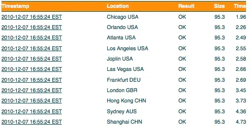

I don't know what your site URL is but you can use Alertra to compare loading times from various locations.

by the way my Alertra result is attached
