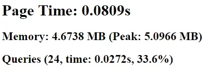

What is the mechanism which gets your query count so low? Is that just caching?
Forum Index
Page Time: 0.0573s
Memory: 3.9599 MB (Peak: 4.2389 MB)
Queries (15, time: 0.0073s, 12.7%)
Thread
Page Time: 0.0519s
Memory: 3.9745 MB (Peak: 4.1951 MB)
Queries (21, time: 0.0095s, 18.3%)
New Posts Results Page
Page Time: 0.0281s
Memory: 3.6023 MB (Peak: 3.7971 MB)
Queries (7, time: 0.0034s, 12.1%)
Though I must admit that we have quite powerful machines running MariaDB :)
That is pretty impressive. Is it all just raw server power (specs?) or have you made other optimisations?
That being said, shaving < 100ms off your database response time (ie going from around 80ms to just under 10ms) is probably not going to achieve as much of an overall performance boost (from an end-user-perspective) as optimising the HTML page load times would - given they are typically measured in seconds, not milliseconds!
The DB server isn't actually optimised that well as I'm not a MySQL tuning expert like eva2000, but we've done a few things to do caching on the PHP side.
HW is a Dell PE730xd with 2x Xeon E5-2630v3@2.4GhZ, 128 GB RAM, 2x DC S3610 SSD handing about 500 GB databases for our ~ 70 forums.

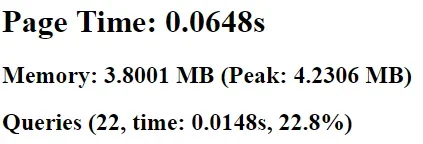

Forum List
Timing: 0.0430 seconds Memory: 4.606 MB DB Queries: 17
Timing: 0.0475 seconds Memory: 5.371 MB DB Queries: 14
Timing: 0.0436 seconds Memory: 5.371 MB DB Queries: 14
Timing: 0.0492 seconds Memory: 5.371 MB DB Queries: 14
Timing: 0.0472 seconds Memory: 5.371 MB DB Queries: 14
Thread View
Timing: 0.0566 seconds Memory: 5.422 MB DB Queries: 20
Timing: 0.0590 seconds Memory: 5.422 MB DB Queries: 20
Timing: 0.0577 seconds Memory: 5.422 MB DB Queries: 20
Timing: 0.0573 seconds Memory: 5.422 MB DB Queries: 20
Timing: 0.0571 seconds Memory: 5.422 MB DB Queries: 20
34 addons & 10+ template mods only addons
5.6M Post
Server Specs:
Intel Xeon E3-1245v5 - 4c/8t
64GB DDR4 ECC 2133 MHz
SoftRaid 2x450GB SSD NVMe
