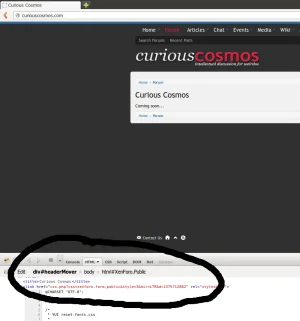

I moved my xenForo installation to a new host last night, and it keeps losing it's CSS. If I toggle between templates-as-files and back, it comes back for about an hour, then goes away again.

CSS will go away about once every 30 minutes to an hour. Thought it was CloudFlare, totally nixed that and am running on MT's vanilla nameservers... No CDN or anything like that.
Thought it could have been some of my addons, disabled all of those with no effect. It ONLY seems to come back if I make a style change (sometimes) or toggle between database and file-based templates (most times).
It's happened once more that I've noticed since I created the thread. If it happens again I'll capture a screenshot and the source and paste it here. Mike, if you or someone need access to troubleshoot, let me know.
Alright, happened again.
Here's a link to a screenshot:
http://imgur.com/RJqgNrF

The CSS referenced below returns blank files for me:
HTML:
<link rel="stylesheet" href="css.php?css=xenforo,form,public&amp;style=3&amp;dir=LTR&amp;d=1375712082" />
    <link rel="stylesheet" href="css.php?css=EWRblock_StatusUpdates,EWRporta,bb_code,dark_postrating,dark_taigachat,moderator_bar,nat_public_css,node_category,node_forum,node_list,node_page,panel_scroller,sidebar_share_page&amp;style=3&amp;dir=LTR&amp;d=1375712082" />
1) Check your error logs and look for any error when accessing css files. It is normal to see blank files when opening css files from the browser though.
2) If you don't see anything on your error logs, navigate your site with a browser that supports inspector (actually, I think every browser has an inspector built in). The moment you lose all your CSS, open the inspector and see the CSS files by your self. In Firefox is very easy to do so and it will allow you to see what the browser downloaded as CSS Files. See my attachment for instructions
This error is frequent when developing addons. If an error is triggered when a CSS file is being accessed, you will see the site without styling. Deactivate your Listeners and see if that fixes the problem.
