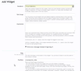

As for the right sidebar, [bd] Widget Framework works with Simple Portal. CWS may as well, but we have not tested that one.
In future versions, we plan to include additional framework support for use on the left sidebar.
Instructions to use the [bd] Widget Framework on the portal
