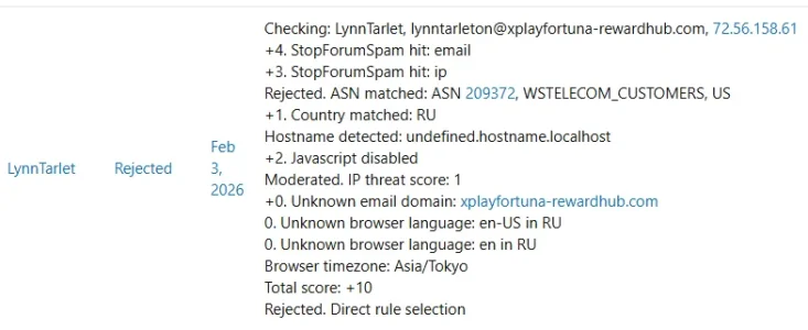

Just to touch on this, we processed ~28,600 registrations in FY25. We found that just blocking the '.' method in gmail addresses AND the at-risk ASN's, eliminated about 98% of spammers trying to use gmail accounts. There are a couple of sites out there using gmail temp addresses like "somethingrandom+owpvo@gmail.com" and those were easy to pickup and blacklist with a filter. We don't see much Yahoo anymore these days.
We see crazy nonsense more often now that looks like this:
That particular ASN is driving a lot of trash...
In those cases, SFS does a pretty decent job of snagging them first. We did also lockout non-standard TLDs like .casino, etc.
There was a lot of attempted trash coming from them.
