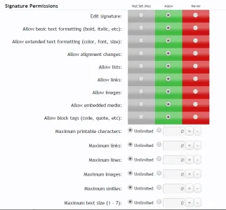

The signature option is missing from my CPanel and "account" page. What gives? I have all signature permissions on allow.
I do mean under User CP. Like here on xenforo u have "signature" under user CP, this isn't visible on my site for any of the users. Is there an option to disable it in Admin CP?? Since it isn't showing.

Hi, so we just launched our official new forum tonight, and I also cannot see the signature option (super admin) and neither the members. I analysed the permissions but everything is fine. I have the maximum character to unlimited. What else can I try?
Thanks!
Use the Analyse Permissions in the ACP to check the final permissions for you and your members.
ah, once you change the values from unlimited to anything, THE SIGNATURE OPTION APPEARS automatically in your profile.
Thanks!
Unlimited should be fine. If it's not working, do analyse permissions and also check if there are any conflicts with other add-ons.
Unlimited should work, though.
Do you have any add-ons that have anything to do with signatures installed?
Not that I know of, no... but changing to real numbers seems to have worked, so now to the next issue I can't figure out, I'd love to be able to go to bed... :p

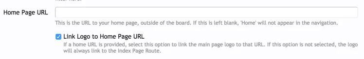

I'm trying to change the URL for the little house/home icon left of the FORUM link on the main menu. I read many posts that all say to edit a certain template, but nobody is giving any actual code, so I have no idea how I should format my modification.
The forum is here: http://vi-control.net/community
The HOME would link to an external page: http://vi-control.net.
Thanks for any help!
Not that I know if, no... but changing to real numbers seems to have worked
What happens if you switch back to unlimited? Does it stop working, or does it continue to work?
You do need to resolve this issue completely as there may be other issues relating to this that you haven't yet discovered. You'll need to disable all add-ons and test in an unedited default style.
Put the URL here in ACP > Options > Basic Board Information
Thanks! for the Home page that worked!
