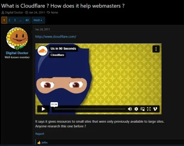

Cloudflare certainly became a huge success.
In 2011 it was just a tiny company but they've become to go to solution for it seems a big chunk of the internet.
