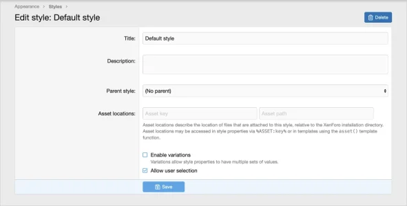

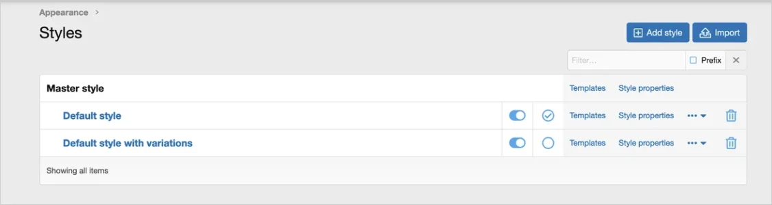

You can do this by having two styles, a Default style and a Default style with variations.
The Default style will have the Enable variations unchecked.
The Default style with variations has the Enable variations checked.
Because I just want to offer dark style, but not prefer it by system settings. But yes, I understand the point. I'll just have to maintain two styles. I just thought variations could be used as a second dark style, but that system setting cannot be disabled.
