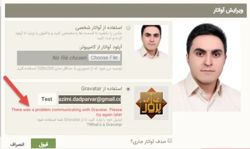

I try to change my avatar to use gravatar, and when I clicked on Test in box, an error came:
I don't know what is the problem with it, but for now, I'll disable it.
If anyone could find the reason, sharing it will be appreciated.
