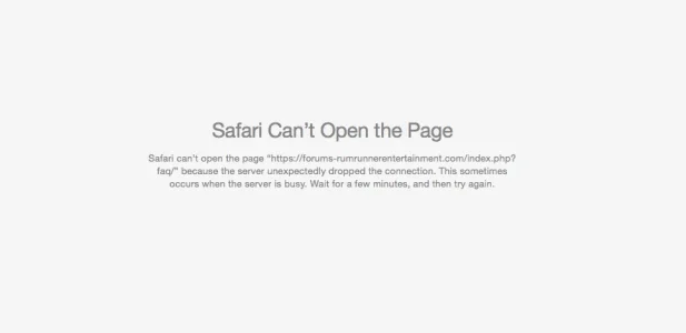

These types of errors on Safari:

So I was looking through my hosting CPanel and I found information on CPU and Concurrent Usage. I've noticed that everytime this error pops up, and the page is un-loadable, that the CPU reaches its max and the chart showing the usage peaks. I was told by my host that it could be an addon causing this issue or an overall increase of site guests? I'm not entirely sure if that's accurate or not, but that's what I was told.
