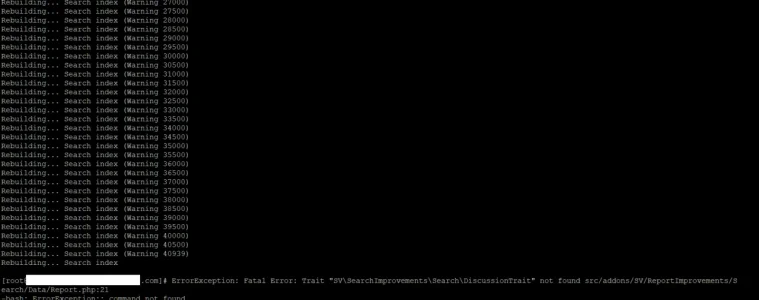

I've removed the plugin during some tests and got the following;
  • ErrorException: Fatal Error: Trait "SV\SearchImprovements\Search\DiscussionTrait" not found
  • src/addons/SV/ReportImprovements/Search/Data/Report.php:21
suggestions? it seems as if Xen is still trying to call the plugin,.
rebuild search index with delete first
ErrorException: Fatal Error: Trait "SV\SearchImprovements\Search\DiscussionTrait" not found src/addons/SV/ReportImprovements/Search/Data/Report.php:21
and yet the file exists and the plugin is activated. if I uninstall it to bypass, the plugin still acts as if its "enabled", rather perplexing.
I've recently bought elasticsearch (several hours ago) and i would like to use it. In this instance as I write this, I've "uninstalled" the plugin via the admincp: I visit the elasticsearch panel and get hit with a 500. If I go to root domain and go /search/ i hit a 500.
Uploading the plugin again allows me to access the admin/search but I cannot rebuild as it then outputs the "not found" error again despite it physically being on the server.
I'm wondering if there are some residuals left over in the DB causing the conflict or something causing the intermittence. Maybe its a conflict with Report Improvements. I will remove this and update you all.
Update; began a rebuild # php cmd.php xf-rebuild:search --truncate
Update. All working now and able to rebuild since the removal of the report adding. Could be singular to me though.
Report Improvement requires Search Improvements, so this is expected. XenForo's requirement system isn't robust enough to prevent an admin from disabling an add-on which is required by another add-on. Or at least disabling anything which has a dependency on the add-on you just disabled.

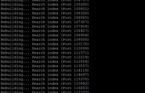

Reindexing search is always a good time.... one hour in, still not done with Conversation Messages (3m indexed thus far)...
